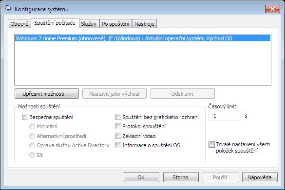

MSCONFIG

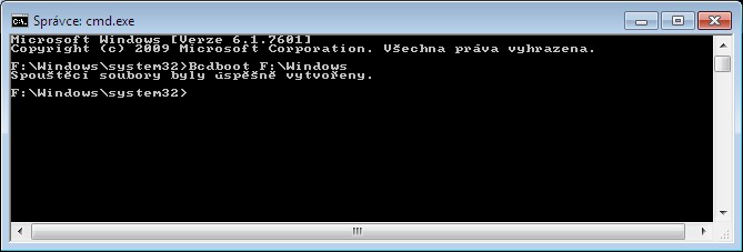

bcdedit /create {ntldr} - jde
bcdedit /set {ntldr} - nejde
