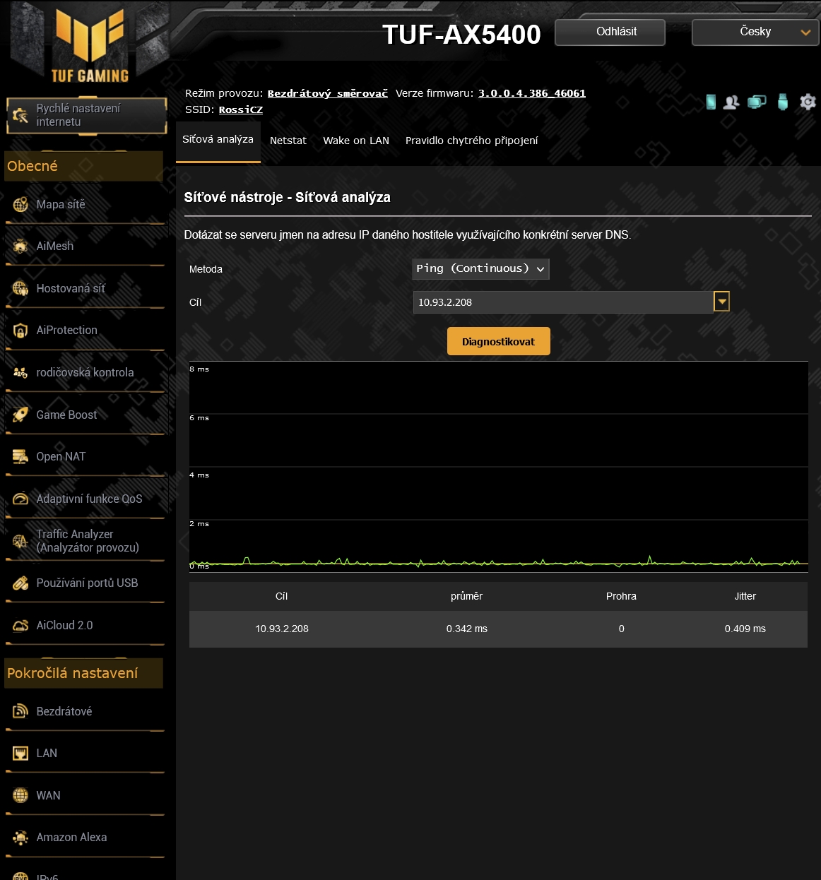

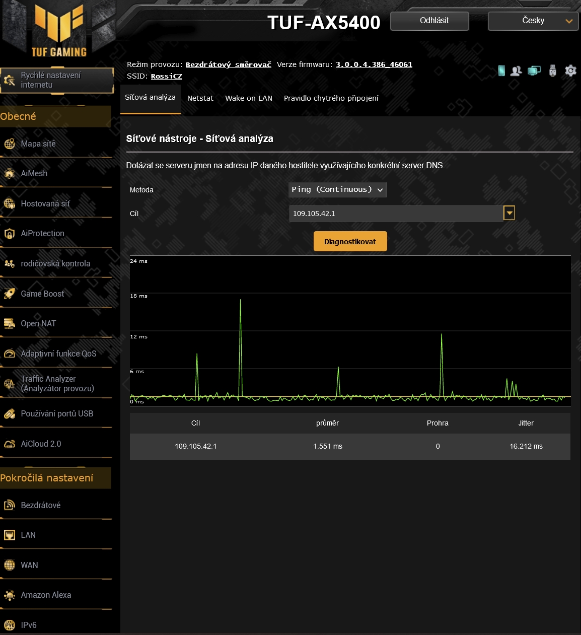

Koukam do logu routeru a co 3h:
2022-06-08 21:31:46|System|Notice|WAN connection INTERNET_R_ETH4:IPv4 connected
2022-06-08 21:31:46|System|Notice|SNTP sync success.server ip:83.***.*.214,date:Wed Jun 8 21:31:47 2022,time zone:GMT+01:00
2022-06-08 21:31:44|System|Notice|WAN connection INTERNET_R_ETH4:IPv4 disconnected
2022-06-08 18:31:45|System|Notice|WAN connection INTERNET_R_ETH4:IPv4 connected
2022-06-08 18:31:45|System|Notice|SNTP sync success.server ip:83.***.*.214,date:Wed Jun 8 18:31:45 2022,time zone:GMT+01:00
2022-06-08 18:31:43|System|Notice|WAN connection INTERNET_R_ETH4:IPv4 disconnected
2022-06-08 15:31:44|System|Notice|WAN connection INTERNET_R_ETH4:IPv4 connected
2022-06-08 15:31:44|System|Notice|SNTP sync success.server ip:83.***.*.214,date:Wed Jun 8 15:31:44 2022,time zone:GMT+01:00
2022-06-08 15:31:41|System|Notice|WAN connection INTERNET_R_ETH4:IPv4 disconnected
2022-06-08 05:24:11|System|Notice|WAN connection INTERNET_R_ETH4:IPv4 connected
2022-06-08 05:24:11|System|Notice|SNTP sync success.server ip:83.***.*.214,date:Wed Jun 8 05:24:12 2022,time zone:GMT+01:00
2022-06-08 05:24:08|System|Notice|WAN connection INTERNET_R_ETH4:IPv4 disconnected
2022-06-07 20:24:09|System|Notice|WAN connection INTERNET_R_ETH4:IPv4 connected
2022-06-07 20:24:09|System|Notice|SNTP sync success.server ip:83.***.*.214,date:Tue Jun 7 20:24:09 2022,time zone:GMT+01:00
2022-06-07 20:24:07|System|Notice|WAN connection INTERNET_R_ETH4:IPv4 disconnected
2022-06-07 14:24:07|System|Notice|WAN connection INTERNET_R_ETH4:IPv4 connected
2022-06-07 14:24:07|System|Notice|SNTP sync success.server ip:83.***.*.214,date:Tue Jun 7 14:24:08 2022,time zone:GMT+01:00
2022-06-07 14:24:05|System|Notice|WAN connection INTERNET_R_ETH4:IPv4 disconnected
2022-06-07 02:24:06|System|Notice|WAN connection INTERNET_R_ETH4:IPv4 connected
2022-06-07 02:24:06|System|Notice|SNTP sync success.server ip:83.***.*.214,date:Tue Jun 7 02:24:06 2022,time zone:GMT+01:00
2022-06-07 02:24:04|System|Notice|WAN connection INTERNET_R_ETH4:IPv4 disconnected
2022-06-06 23:24:04|System|Notice|WAN connection INTERNET_R_ETH4:IPv4 connected
2022-06-06 23:24:04|System|Notice|SNTP sync success.server ip:83.***.*.214,date:Mon Jun 6 23:24:05 2022,time zone:GMT+01:00
2022-06-06 23:24:02|System|Notice|WAN connection INTERNET_R_ETH4:IPv4 disconnected
2022-06-06 20:24:01|System|Notice|WAN connection INTERNET_R_ETH4:IPv4 connected
2022-06-06 20:24:01|System|Notice|SNTP sync success.server ip:83.***.*.214,date:Mon Jun 6 20:24:02 2022,time zone:GMT+01:00
2022-06-06 20:23:59|System|Notice|WAN connection INTERNET_R_ETH4:IPv4 disconnected
2022-06-06 17:24:00|System|Notice|WAN connection INTERNET_R_ETH4:IPv4 connected
2022-06-06 17:24:00|System|Notice|SNTP sync success.server ip:83.***.*.214,date:Mon Jun 6 17:24:00 2022,time zone:GMT+01:00
2022-06-06 17:23:57|System|Notice|WAN connection INTERNET_R_ETH4:IPv4 disconnected
2022-06-06 08:23:58|System|Notice|WAN connection INTERNET_R_ETH4:IPv4 connected
2022-06-06 08:23:58|System|Notice|SNTP sync success.server ip:83.***.*.214,date:Mon Jun 6 08:23:58 2022,time zone:GMT+01:00
2022-06-06 08:23:56|System|Notice|WAN connection INTERNET_R_ETH4:IPv4 disconnected
2022-06-05 23:23:56|System|Notice|WAN connection INTERNET_R_ETH4:IPv4 connected
2022-06-05 23:23:56|System|Notice|SNTP sync success.server ip:83.***.*.214,date:Sun Jun 5 23:23:57 2022,time zone:GMT+01:00
2022-06-05 23:23:54|System|Notice|WAN connection INTERNET_R_ETH4:IPv4 disconnected
2022-06-05 14:23:55|System|Notice|WAN connection INTERNET_R_ETH4:IPv4 connected
2022-06-05 14:23:54|System|Notice|SNTP sync success.server ip:83.***.*.214,date:Sun Jun 5 14:23:54 2022,time zone:GMT+01:00
2022-06-05 14:23:52|System|Notice|WAN connection INTERNET_R_ETH4:IPv4 disconnected
2022-06-05 08:23:52|System|Notice|WAN connection INTERNET_R_ETH4:IPv4 connected
2022-06-05 08:23:52|System|Notice|SNTP sync success.server ip:83.***.*.214,date:Sun Jun 5 08:23:53 2022,time zone:GMT+01:00
2022-06-05 08:23:50|System|Notice|WAN connection INTERNET_R_ETH4:IPv4 disconnected
2022-06-05 05:23:51|System|Notice|WAN connection INTERNET_R_ETH4:IPv4 connected
2022-06-05 05:23:51|System|Notice|SNTP sync success.server ip:83.***.*.214,date:Sun Jun 5 05:23:51 2022,time zone:GMT+01:00
2022-06-05 05:23:49|System|Notice|WAN connection INTERNET_R_ETH4:IPv4 disconnected
2022-06-05 02:23:49|System|Notice|WAN connection INTERNET_R_ETH4:IPv4 connected
2022-06-05 02:23:49|System|Notice|SNTP sync success.server ip:83.***.*.214,date:Sun Jun 5 02:23:49 2022,time zone:GMT+01:00
2022-06-05 02:23:46|System|Notice|WAN connection INTERNET_R_ETH4:IPv4 disconnected

Ono to vypada dle screenu, ze tyhle udaje ma z DHCP, tzn od poskytovatele a nemuze je ovlivnit.
Udelat zapujcku IP ma minuty je jednak prasarna, druhak to musi mit nejaky duvod aby takovou prasarnu
nekdo udelal a nekdo to musel schvalit. Poskytovatel moc dobre vi, cim to je a ze je to jeho dilo.
Tech lidi musi byt stovky se stejnym problemem - nema poskytovatel nejake diskuzni forum?

Dle screenů je jsou to síťové nástroje, které jsou součástí výbavy asus routerů. Navíc nevím, co tam pingá - svou IP? To je špatně už z principu.
osobně si myslím, že máš pravdu, oni si to prostě během těch testů při změně IP pohlídali (nebo to padlo zrovna do intervalu).
Ještě je taky možnost, že mu dodají "svůj" router za jiné peníze, který zázračně bude fungovat.
jak jsem psal pingplotter a reklamace, reklamace.
