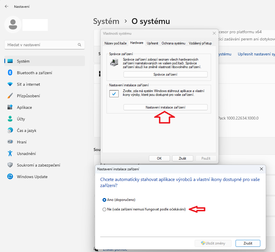

Driver Management has concluded the process to add Service IntcAzAudAddService for Device Instance ID HDAUDIO\FUNC_01&VEN_10EC&DEV_0257&SUBSYS_17AA5125&REV_1000\5&28CBF551&0&0001 with the following status: 0.
toto vypisuje v detailoch ovladaca, ono tam najprv bolo Realtek High Definition Audio, no ale potom sa to zmenilo na Realtek(R) Audio, zaklikla som to, aby to neupdatovalo automaticky a zvolila "Nie" v prilohe vyssie.
