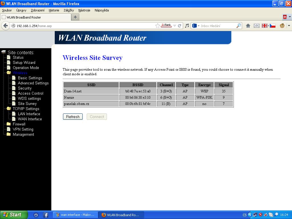

mam taky problem mam routerWLAN broadband router bydlel sem jinde tam sem mel router nastaveny a fungovalo po nejake dobe sem se odstehoval tu je wifi pripojeni router mam wifi vlezu do nastaveni na dal sem wirlese site survey refresh a naslo to tu sit co potrebuju ale tlacitko conect je zasedle a nejde se k te siti pripojit heslo na sit mam ale nemohu se pripojit diky za radu

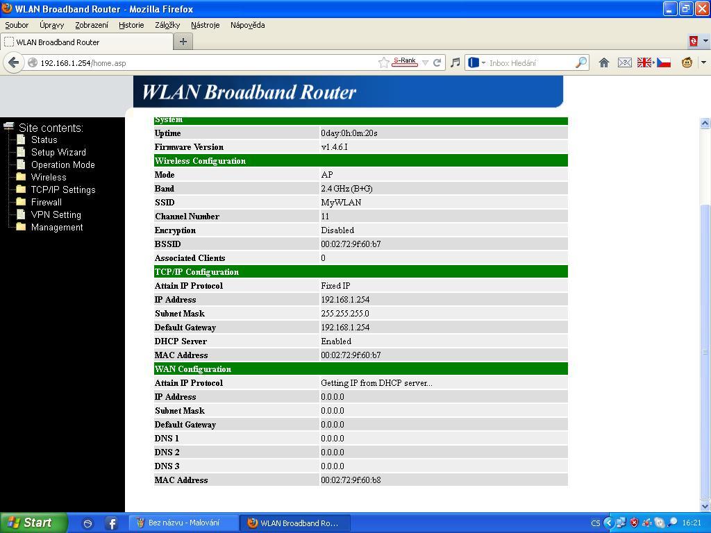

tu je status routru
Uptime 0day:0h:28m:45s
Firmware Version v1.4.6.I
Wireless Configuration
Mode AP
Band 2.4 GHz (B+G)
SSID MyWLAN
Channel Number 11
Encryption Disabled
BSSID 00:02:72:9f:60:b7
Associated Clients 0
TCP/IP Configuration
Attain IP Protocol Fixed IP
IP Address 192.168.1.254
Subnet Mask 255.255.255.0
Default Gateway 192.168.1.254
DHCP Server Enabled
MAC Address 00:02:72:9f:60:b7
WAN Configuration
Attain IP Protocol Getting IP from DHCP server...
IP Address 0.0.0.0
Subnet Mask 0.0.0.0
Default Gateway 0.0.0.0
DNS 1 0.0.0.0
DNS 2 0.0.0.0
DNS 3 0.0.0.0
MAC Address 00:02:72:9f:60:b8

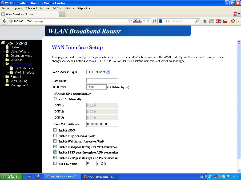

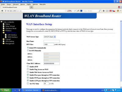

tu je nastaveni WAN
WAN
WAN Access Type: DHCP Client
Host Name:
MTU Size: 1400 (1400-1492 bytes)
Attain DNS Automatically
Clone MAC Address: 000000000000
Enable uPNP
Enable Ping Access on WAN
Enable Web Server Access on WAN
=Enable IPsec pass through on VPN connection
=Enable PPTP pass through on VPN connection
=Enable L2TP pass through on VPN connection
Set TTL Value (1-128)

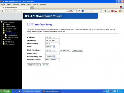

tu je nastaveni lan
LAN Interface Setup
IP Address:192.168.1.254
Subnet Mask:255.255.255.0
Default Gateway:0.0.0.0
DHCP: server
DHCP Client Range: 192.168.1.100 192.168.1.200 -
Domain Name:
802.1d Spanning Tree: Disabled
Clone MAC Address 000000000000

SSID BSSID Channel Type Encrypt Signal
Dum-14.net b0:48:7a:ec:53:a0 3 (B+G) AP WEP 40
tuhle sit mi nasel muj router ale pod timhle jsou dva cudliky refresh a conect na conect nelzekliknout

Dej raději screen jak to vypadá,to zašedlé connect.Ten udělaj přes print screen na klávesnici a dáš to přes CTRL V do malování,uložíš jako JPG a upneš na forum.

a wan iterface
a wan iterface
lan iterface
lan iterface
status routru tovarni nastaveni
do site dum 14 net se chci pripopjit ma i heslo site ale nemuzu conect
--- Doplnění předchozího příspěvku (17 Pro 2012 16:34) ---
dum 14 net je ssit co nam tu udelal majitel a mame heslo
